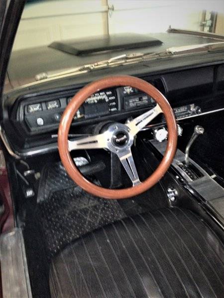

I put a walnut Grant steering wheel on my 1968 satellite GTX clone convertible, but cannot get the horn button installed correctly, so I'm driving with no button or functioning horn.
Has anyone installed an aftermarket Grant wheel that has access to a photo of the horn button assembly and how it goes together? Seems easy, but...Would appreciate any help.
