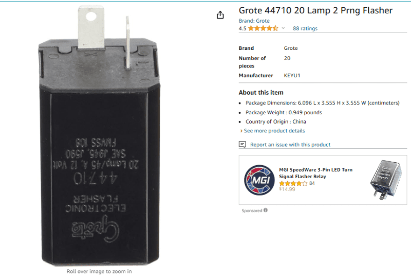

Here is the correct flasher to use with LED's
