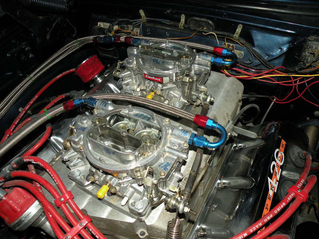

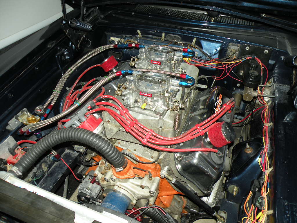

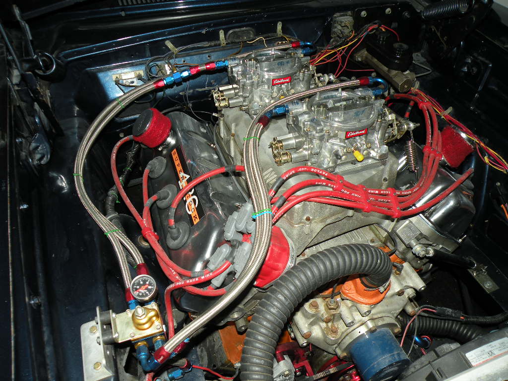

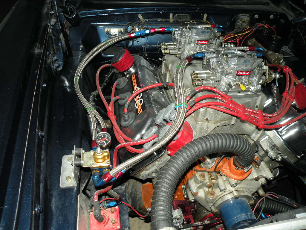

im using cometics on my 581 ci aluminum indy headed hemi. ni issues.
