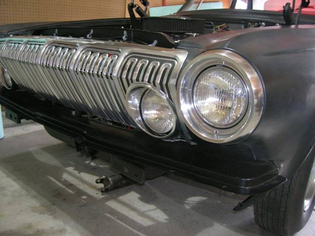

Has anyone tried putting 1964 Dodge outer headlight bezels on a 1963 Dodge outer bezels, I got one on and need to retrofit the other side, I like the way these look better than the factory ones, they are alot heavier duty also. I will post some pics when i get both sides done.
I purchased a 63 Polara from a guy who used 64 Dodge headlight bezels on it. He ground down the 3 square bulges on the back side to mount them flat.
I took them off when I found a pair of 63 bezels.
cool mine came off one of our parts cars, saved me some $$$$$$$$$$$$.
Your originals look saveable.
My orignals were pounded pretty hard and I managed to get them worked back out...
I think I will leave the 64 ones on, it will match everything else that doesnt go together. No restoring this go around just putting everything together to get it on the road.
