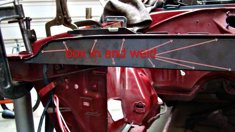

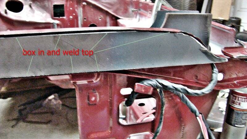

Hello folks I am looking for a couple of pictures of the radiator support with the wiring in place on my 67 Coronet.
I need to can see the top front side showing the routing across both ends and where it exits.
I have my harness some what in place but need to see how it is routed on both sides both side but need more from a car that is completed.
I am boxing in the top of the radiator support for additional support.
The boxed in part will be removable so if I ever need to access and remove the harness at some other point and time.
I have never seen my wiring it place was missing when I bought the car.
I could not find what I need here on B bodies in the archives.
Thank all... for your help and especially Jerry Hall
Mike:praying:
You may as well make it out of plastic - there will be no additional support unless you weld it in place.

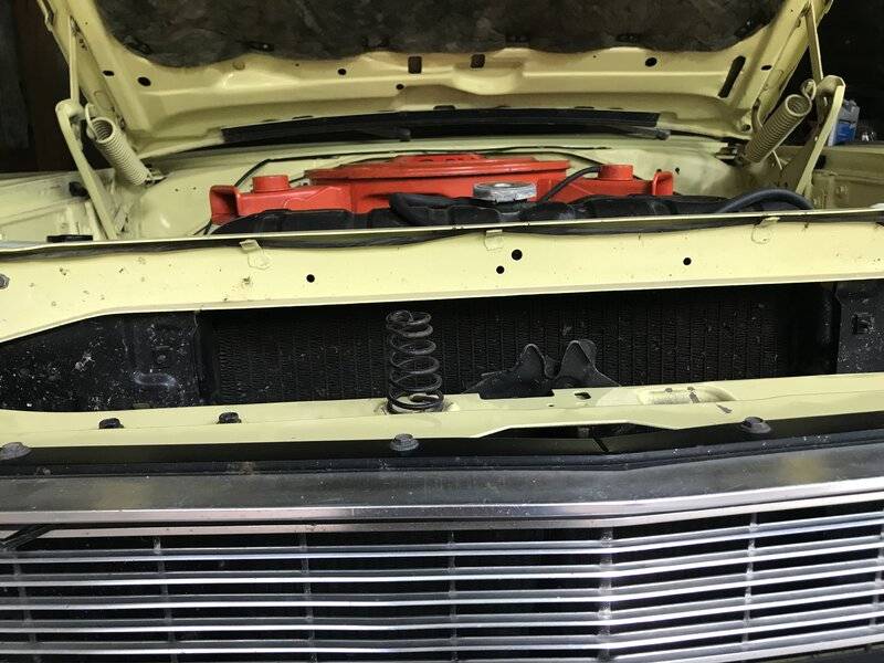

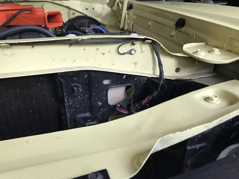

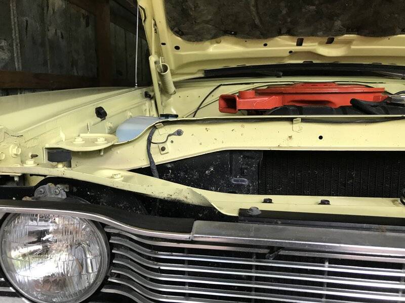

Check your PM, I didn't get out yesterday. You have pictures today from 67 GTX. Should be the same as 67 Dodge Coronet.
If you want anything else, I won't be here long it's 107 heat index and 90% humidity.
