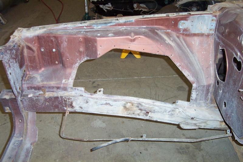

How did you do the BB conversion? BB K-frame or the conversion mounts? Also 73-up has a BB pass inner fender thats different than the SB one.

i used factory bb k frame. the motor mounts i used i checked part #s and for 73-74 b body cars.the only thing i did was but in new rubber mounts in to the metal part of the mount. im running headman headers.sorry every one im not good at spelling or puncuation my bad. but thanks for every ones help!!!
