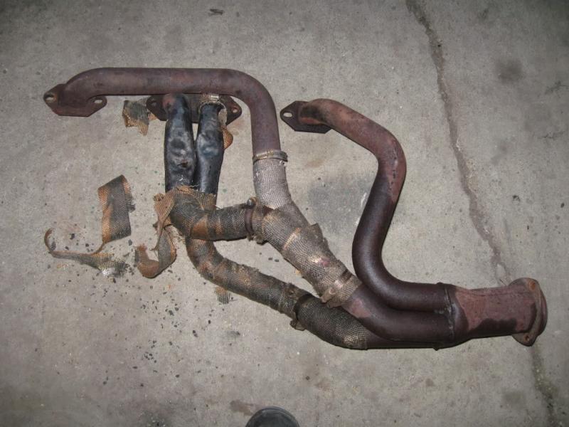

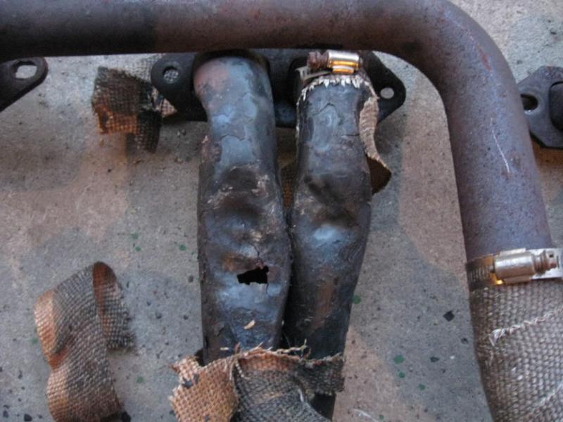

Here is my driver side header. It was 15+ years old but they'd still be on the car if I didnt wrap it. Passenger header was fine.
New headers did not get wrapped.
That's what my buddies looked like.....

Hate it, blew a nickel sized hole in a set of headers .
