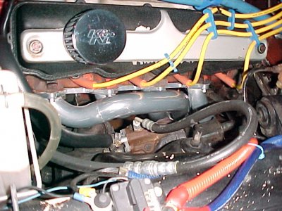

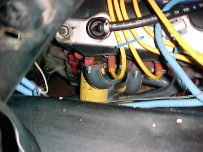

I can't speak from lots of experience, but I'm a believer of TTI Exhaust. They used my car to test fit the Poly Headers and they are awesome.
The nice thing about TTI is they only make Mopar Headers, and they design them so that they all exit at the same location for your car. So if you have a small block and change to a big block, you wouldn't have to change your exhaust, because their big block headers will bolt to them.
They also design them so that you don't have to remove the engine, but when they say things like: raise the engine about 2", remove the starter, remove the oil filter (Poly 318 instructions) they mean it. As soon as all three conditions where met, the headers came right out.
