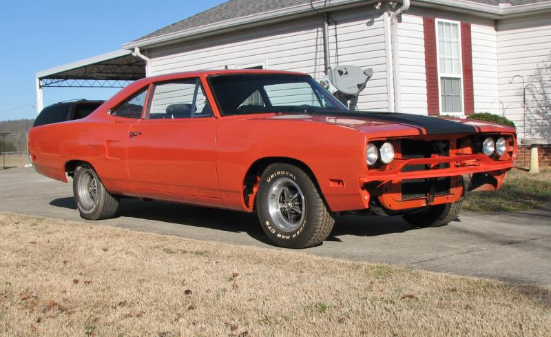

Where exactly is the headlight delay relay located on 70rr. this car i bought has a yearone dash harness(main harness) and i think it will fit other models such as 70 charger.so i have more wires than i have places to plug them in.most everything works ,so ive got most of it plugged in the right spot.but i do have some wires that my diagram says goes to the head lamp dely relay,but i cant find it.does anyone have a picture or drawing of one and where it goes? thanx IMG_1920.jpg
If I am not mistaken that would be only for cars with the A01 option. If your car did not come with that lighting option, you should not have that relay unless someone added it. It is late, so someone can correct me if I am wrong, but pretty sure I am right.
Sorry, actually it is coded as L42 option. So there I corrected myself. I was wrong. What it does is keeps your lights on shortly after you turn your car off. It was an option and not standard.
thanx guys.lights work fine .so ill do without delay
