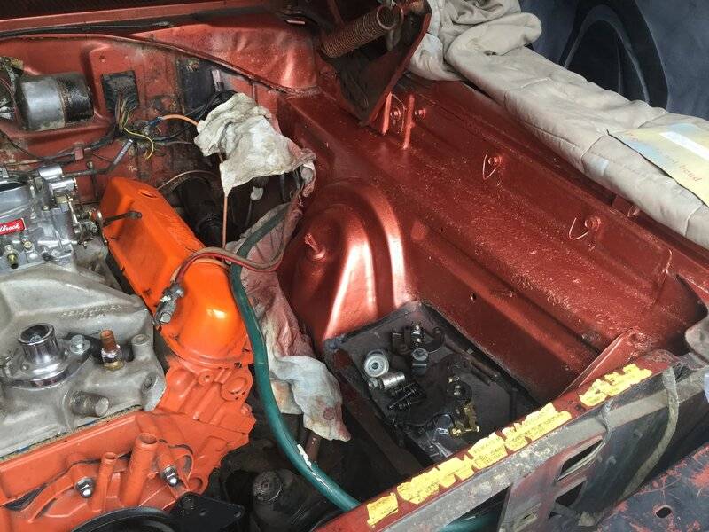

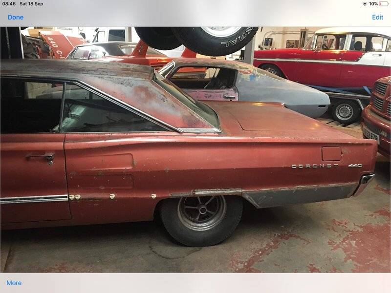

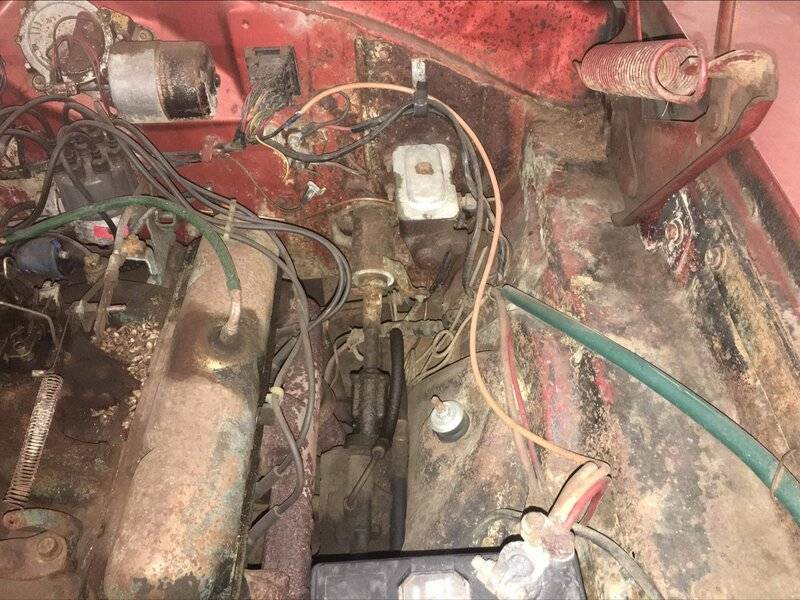

I’m pretty sure I can source lights, may UK classic cars have similar set up. I appreciate the help guys. Car was a barn find pulled out of Tennessee and ended up in my garage a few weeks ago
