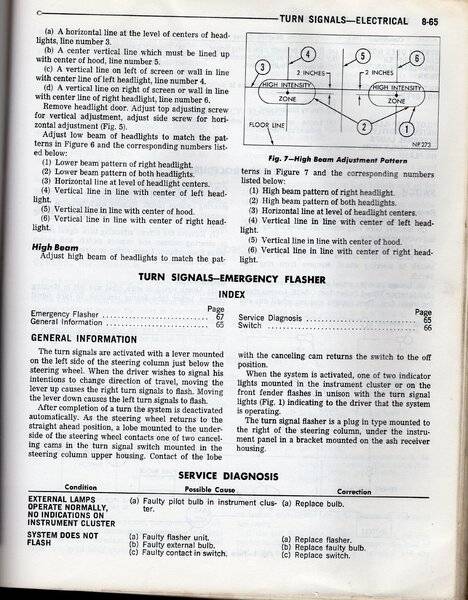

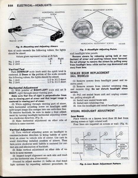

When putting the front end back together (and of course the headlight buckets), I realized I needed to re-align the headlight beams.
Does anyone have valid info for height and distance from the wall to get the beams properly aligned? I believe the distance is 25', but not sure. Height?... no idea. Thanks guys.
Here you go from the 68 FSM Charger/Coronet/Dart.
