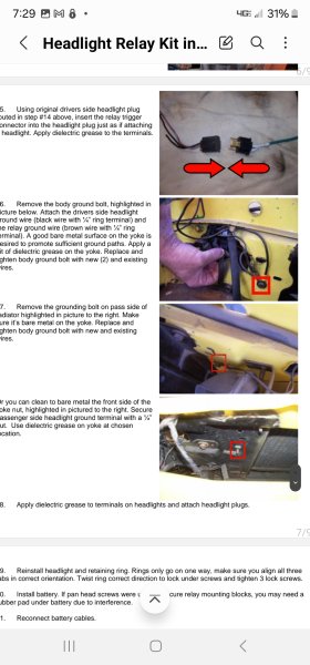

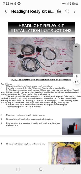

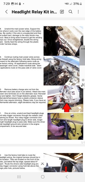

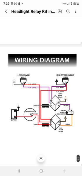

I purchased the headlight relay system from @Crackedback a while back for a 1964 Polara and am just getting around to installing it. I've read in other posts that instructions were included however I can not locate them.
I tried messaging him directly but his inbox is full.
Would anyone be able to email a copy of the installation instructions please. I assume that they are mostly vehicle specific.
Thanks ... Jim
I Have them give me a little bit I'll post them
Send me a PM in a few hours. I have the paper copies in my shop and I'll be out there later. I can snap a few pictures.

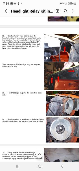

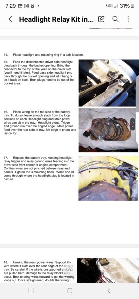

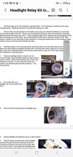

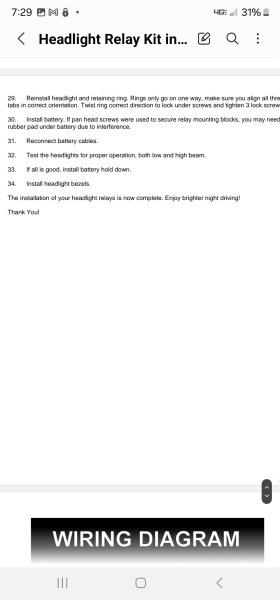

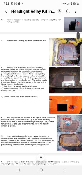

Here you go didn't realize you cant load pdf files so I screen shot it. If you want the pdf file pm your email address
I’m out in the shop now if you want bigger pictures.
