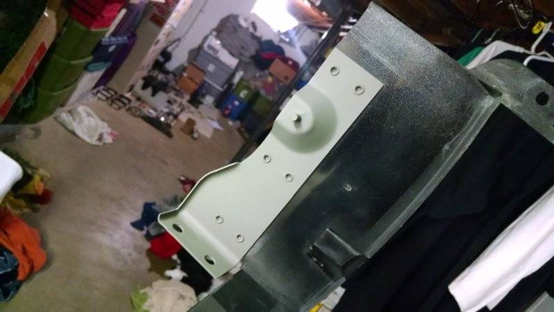

If you are talking about where the headlight door pivots are, the pivot brackets are attached to the grille and outer extensions.
Here are a couple of pics from my grill restoration. The pivot brackets are riveted to the actual grill.
