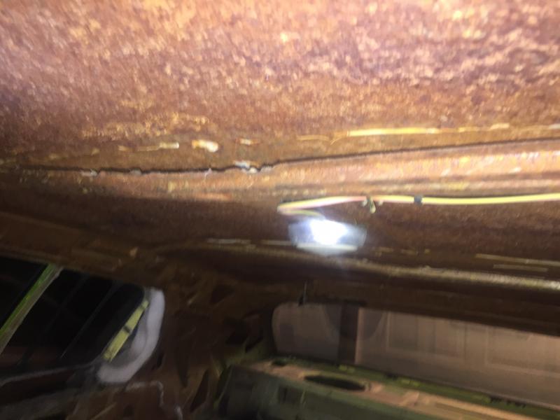

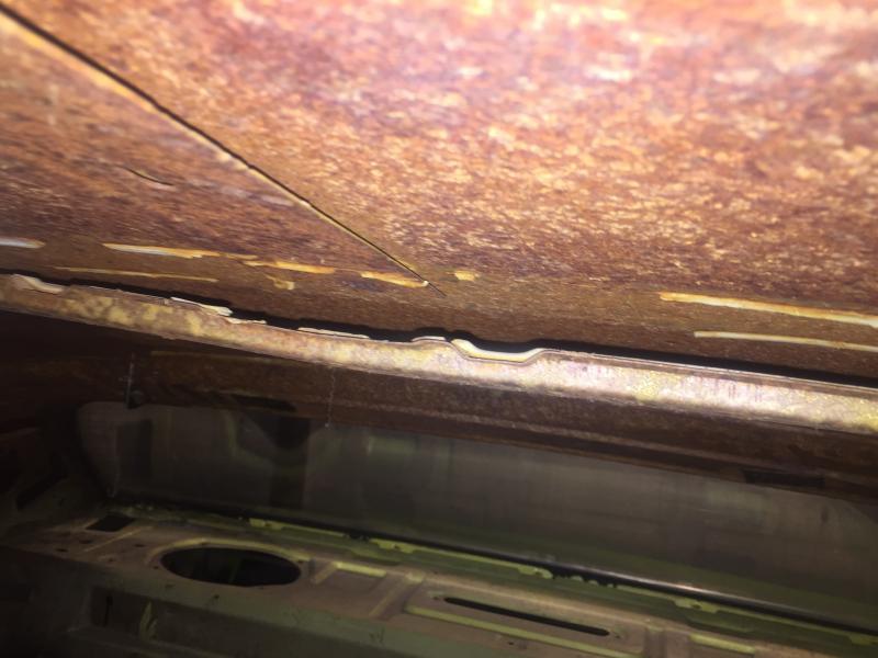

so the old owner who did all my body did not fix the roof support, it is hanging lower than the actual roof, (probably left outside in snow or something collapsing it)
but how would you fix this without welding it. paint and everything already done, i was thinking some sort of jb weld type stuff with a 2x4 pushing it up, but help would be greatful
as well as the carpet that i have is not moulded, so would i just cut it down to size and then steam fit it?
It sits about a inch to inch and half off the roof itself,
sorry for bad pics it's dark out
It is just spot welded on each side by two places. Drill it out, straighten it and tack it back in. Should be able to do it without heating the roof as the bracket it attaches to is a separate piece. Look in the link below. Mine isn't painted, but I'm sure you or someone can do it safely.
