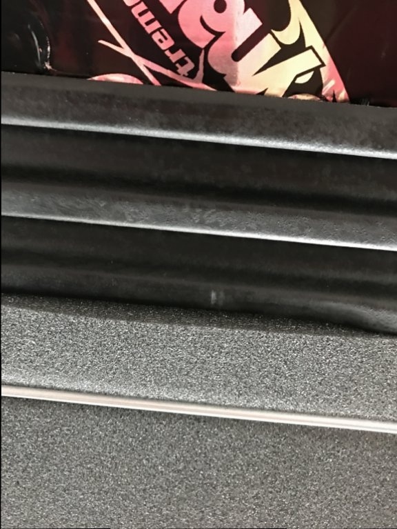

Ok, I asked the question a while back on headliner thickness. The verdict was 1/2". Here is my next dilemma, closed cell foam or open cell foam. They both have different characteristics but for me the biggest hold up is the difference in rigidity. Here are 2 picks of both types of foam under the bow but next to the roof rail.
The first pic is the closed cell foam, more rigid, holds the bows away from roof. Similar to Dynaliner. Dynaliner says there's is good for preventing heat penetration. Suppose to be able to deaden sound but I have my doubts being a closed cell.
The second pic is open cell foam, softer, better for noise reduction does not hold the bow away from the roof that much but the foam is at 1/2" before it gets to the roof rail.
Out of all this that you read, here's the question. Does it matter which one I use as long as the foam is thicker than the roof rail or does that even matter?
What I am trying to avoid is getting the foam in and then on installation day I have a problem with seeing the roof rail.
That wouldn't happen on how the headliner is installed. The bows resting on the material provides extra support to hold the bows in place. Without that support I would make sure the headliner is pulled fairly tight on the front. New material will stretch and relax. The other area that locks the listing for the bows is those little roof rail clips.
When my headliner got installed recently the front bow in the center had the listing twist around the bow and pulled the center up a bit. That was due to the roof insulation and when the bows pulled forward the tension rolled a 4" portion of fabric. Easy fix, release the front and release the rollover, thats it and it is common to happen on a bow or two during install. Long winded I know but hope that helps...
So are you saying I could go with a padding that is actually thinner than the roof rail and all I would have to do is pull the headliner tight and the roof rail would not show?
That's is correct....Not crazy tight but tighter....Most people just put dynamat only...
