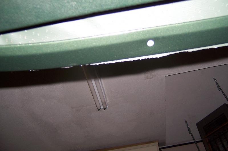

Hi guys,
Not sure about this, but could you tell me if there is any interior trim pieces holding up the front of the headliner in a 68 dodge charger? I looked all over and all I could find is the rear window interior trim pieces. Also does anyone happen to have a picture of how the front part of the headliner is held up?
Thanks guys,
The front of the headliner is held up by installing it on the pointed metal tabs that are already built in the roof structure on the front edge and usually using a light amount of upholstery adhesive is a good idea to help hold it there also. There is a piece of metal painted trim that goes out over that area then also. If you need the rear window trim i have some of it also PM me
Thanks Don
Heres a picture of the trim piece that covers the front.
