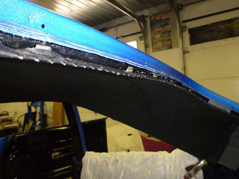

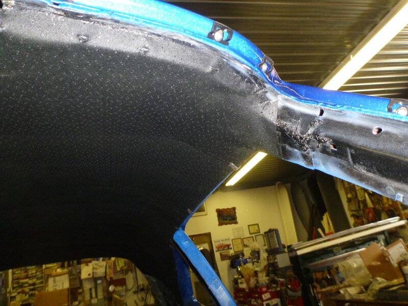

Finishing up a headliner install on my Charger. Have it glued along the sides and at package tray but just pulled tight over the tack strips at front and back windows.
Do you glue along the tack strips too?

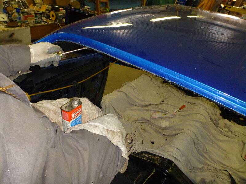

Yes, I put my entire headliner in with ZERO glue and then went back and glued down just the OUTSIDE edges. I've seen way too many cars where someone goes nuts with sprayed glue, while installing, and ends up matting up the interior edges getting them stuck where they shouldn't be. If your happy with the install and it's tightness, just lift a small section at a time (you can see me doing so with the flat screwdriver) and contact cement in place. No need to pull anything off the teeth.

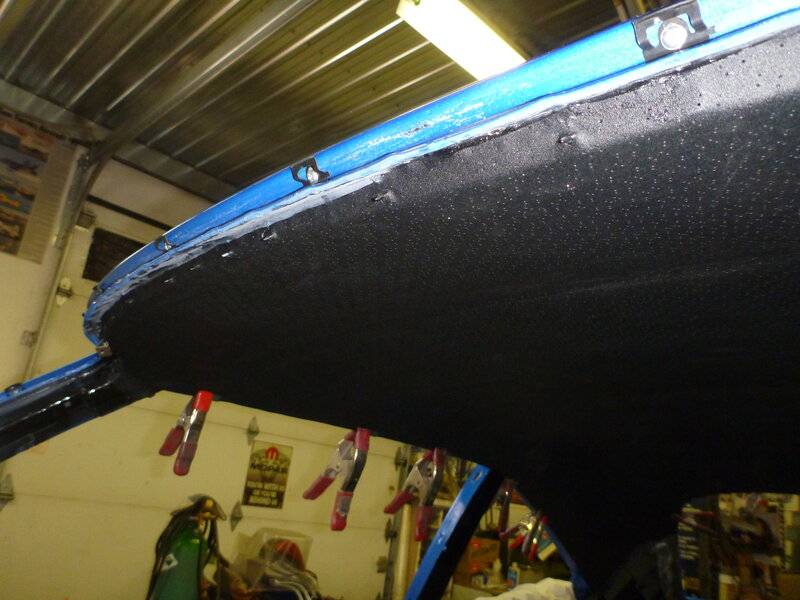

I saw one of your earlier posts about clipping it in first and went at it that way. First time install so can't compare to straight gluing but I think that helped a lot. Made it easy to do adjustments. I used a combo of clamps and the mounting clips and worked great. Peeled back bit by bit and glued once it looked good. Nice tip!! Thanks
Got everything glued up and all the hardware screwed back in. Now to work on these left over wrinkles.......
