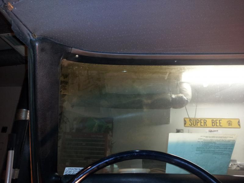

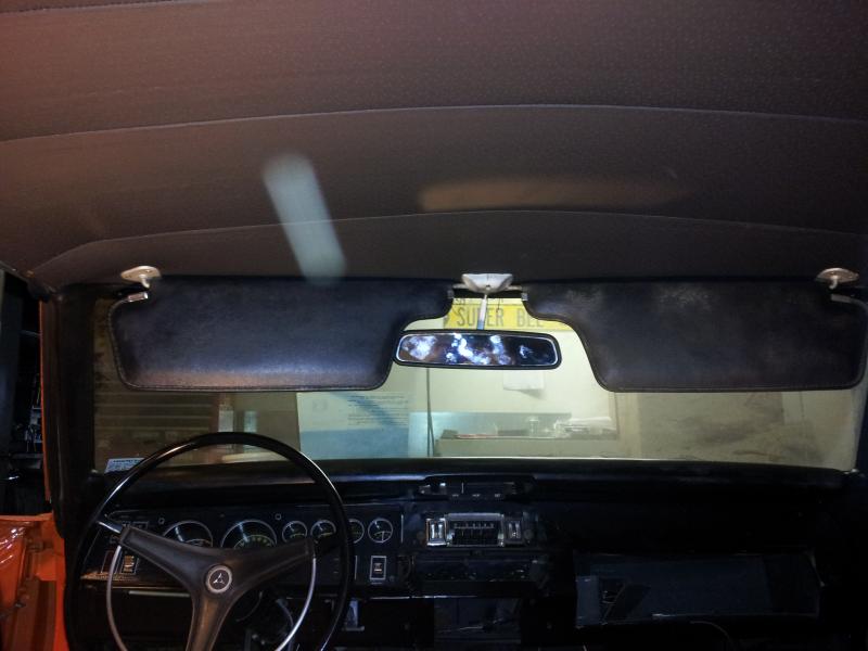

Anybody ever put a headliner in a 69 superbee. I have all of it in except around the back window and the sail panels. I know it goes in some how.If someone could help me out i would apprecate it thanks to any response
Around the back window there should be metal plates with teeth around the top and sides. The headliner is pulled tight then the teeth grap into the headliner. Also the rear most headliner bow has two wire looking hooks that hold the bow up. There are two small bows that go on the sail part of the headliner but I didn't have those so I didn't put them in.
The sail panel boards have clips that hold them in and then you can just glue it to the headliner. To be honest my headliner was tight enough and looked pretty good with out the sail panels but I put them in because the factory did.
In general you want to pull the headliner toward the front so all the wrinkles go lengthwise then pull the sides to take the wrinkles out.
Thanks for response,I have back bow in and the little spring hooks in so far all looks great.I also do not have bows for sail panels, I didn't know they were there.Dosen't rubber trim go in to help hold liner in place on the teeth.I'm going to finish it up this wk. end its going in one way or another thanks again.
