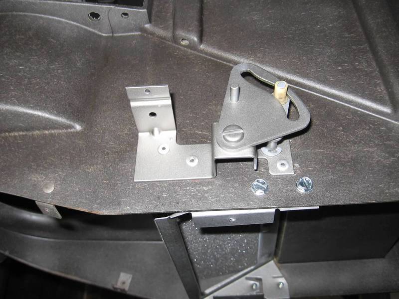

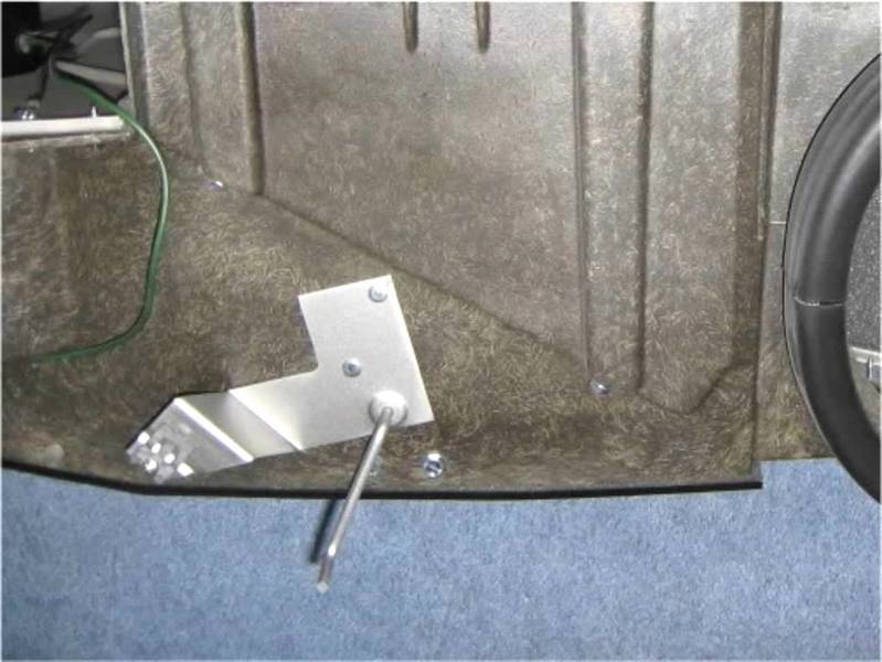

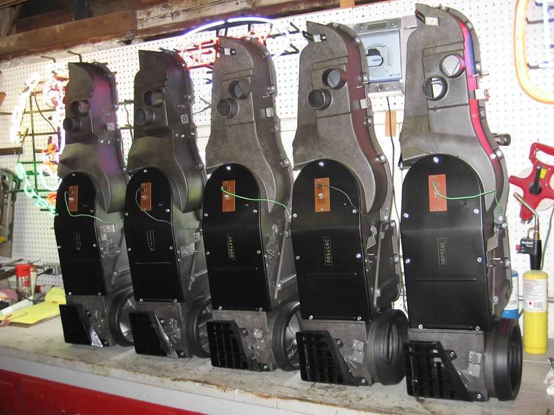

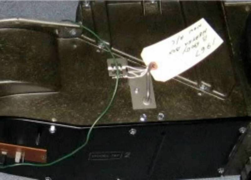

i have to disagree that they are the same from 1966-1970. they will all physically bolt in but ones for 1966-1967, the heat blend door arm is opposite the ones used in 1968-1970. there is also a molding change at the defrost tube outlets for the years 1966-1967 to 1968-1970. the heater core is the same from 1966-1969 (5/8 in 5/8 out). 1970 is 5/8 in and 1/2 out.
here they are all lined up. from left to right 1966 to 1970. there you can see the subtle difference by the defroster outlet.
