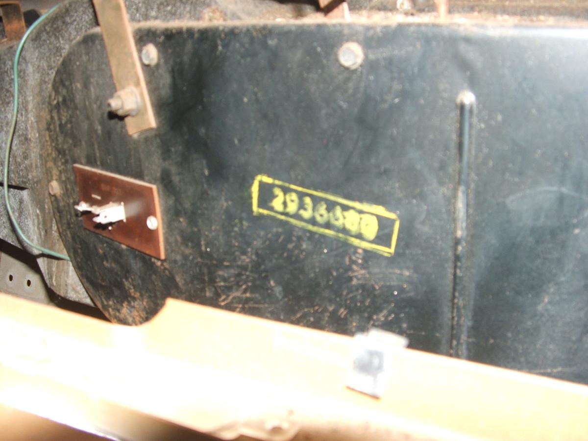

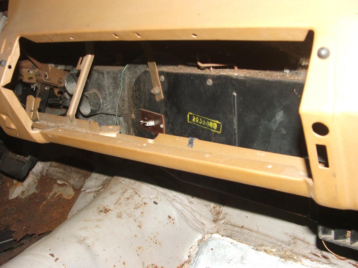

heres the one i have gary,try to reproduce the smeared stamp number like they did on this one.

Tad, or anyone else what is the difference in the stamps. Mine is stamped the same except it has a 1 on the end instead of the 0 other guys stated the same. I wonder what is the difference. They say bead blast the fiberglass but I woner if you could soda blast it with the same results. Tad, I'll be there Sunday at Gilmore's but I don't think I'll bring the car.
it seems to change to a one for the last number if you have a later build date in the year.
