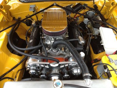

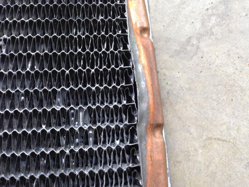

So, my Indy small block 440 with a Mod-Man intake did not come with the water pump bypass port drilled/tapped in the intake. I've read several different opinions on this whether it is actually needed. This engine has a high flow water pump and thermostat and sees 7000rpm+ frequently. The other day, I hit 7000 and popped a brand new heater core dumping 2.5 gallons of antifreeze in the passenger floor well. (What a mess)
Im thinking a bypass hose would keep this from happening again. What else does this hose do and what are the benefits of not running one as opposed to running one?
Sounds like you need a better radiator cap. The bypass hose just keeps a minimum flow through the water pump and heater core when the thermostat is closed. The cap should have relieved the excess pressure WAY before the heater core gave up. Will have to say that the new heater core had quality issues if it gave up like that.
I was kinda thinkin the same thing on the cores lack of quality.....
Correct me if I'm wrong, but if the thermostat wasn't open at the time to allow flow/pressure to the radiator, then 100% of the pump output would be forced through the heater core if there was no pump bypass. Right?

Hydro test the next one at 30psi before you install it
I frankly find it difficult to believe that anything except a flawed core and a high pressure cap was the cause. Those pumps "slip" a bunch, as they are designed to do. They are not "positive displacement" by any stretch of the imagination.
It might well be that the heater core was getting "ready" and that last pound or three of differential pressure was the "straw that broke."
