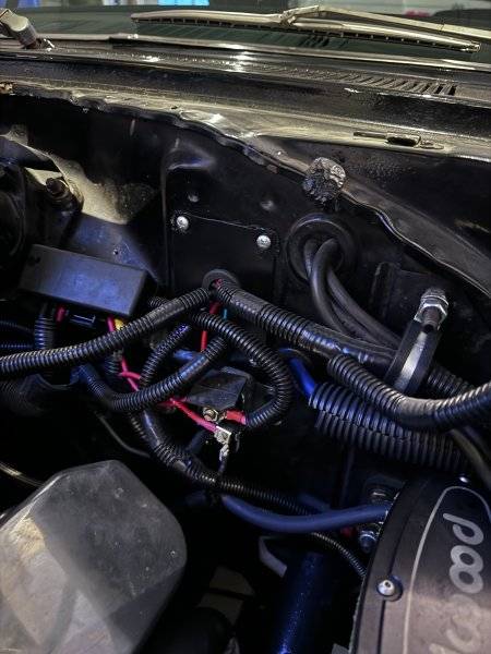

I fabricated some sheet metal where needed. Bought at local Home Depot. Replaced from inside and covered it up with new fuse box and msd. Can’t see anything from engine bay. I took my heater box out when I replaced all the wiring! I fabricated a panel for bulkhead connector too. The car is far from original, so I wasn’t concerned about that. Good luck!
