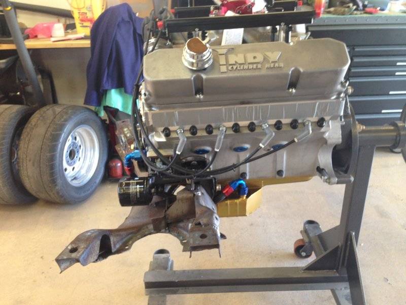

I went big budget. Indy aluminum low deck. Low deck saves a few pounds. If you can get a lighter reciprocating assembly, for sure rev faster plus more weight shaved. The Indy long block is 450 lbs with oil in the pan.
My 540 weighed 420# with the FAST 2.0 installed and oil. Also a low deck block.
