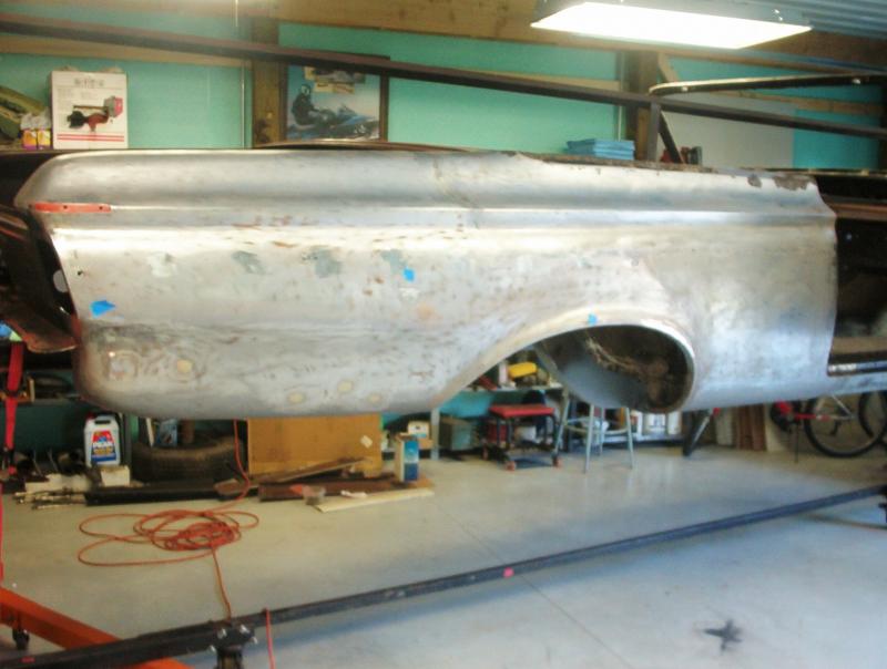

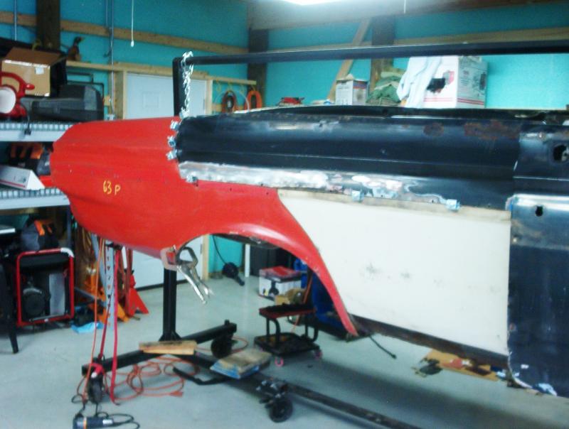

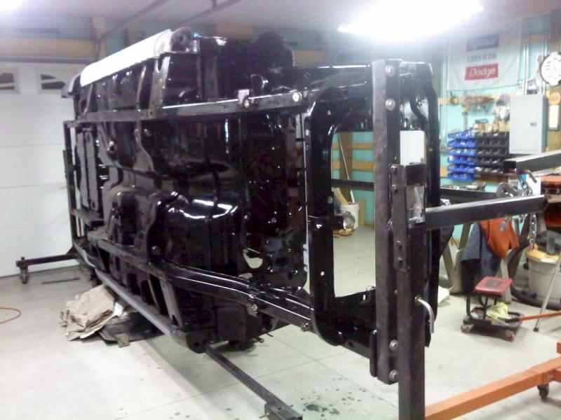

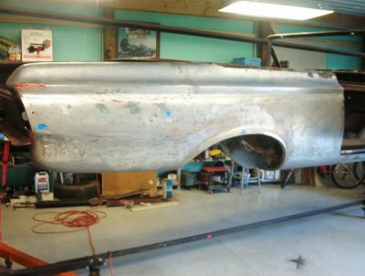

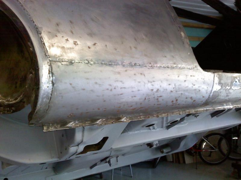

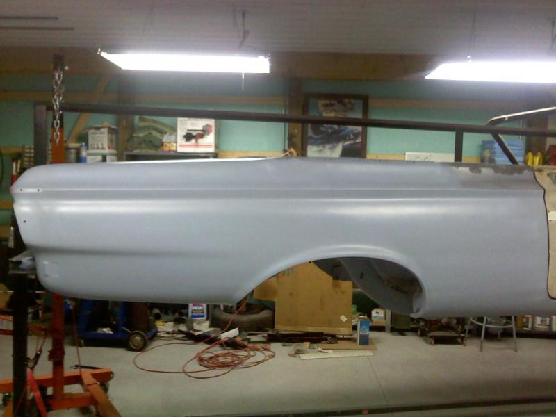

New member from Carlisle PA. Working on a 63 Sport Fury Conv with 318 Poly. Car was very rusty and i used quarters and rear door skins from a 4 door to make the repairs. Hoping to do a stroker poly motor.
Looking forward to sharing and getting some knowledge. Frame was tied together with US car tool pieces. Rotisserie is home made, i use the engine hoist to turn it, crude but cheap lol!
