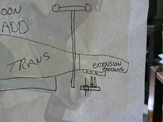

Got my new 727 Transmission in, but my Transmission guy says im missing the Lower linkage (see picture) that bolts onto the extension housing
Its a Console T shifter style-
Does anyone know where to buy one of these or have a extra one sitting around- Or at least a better picture of one
Apreciate any help involved
thx-Dan

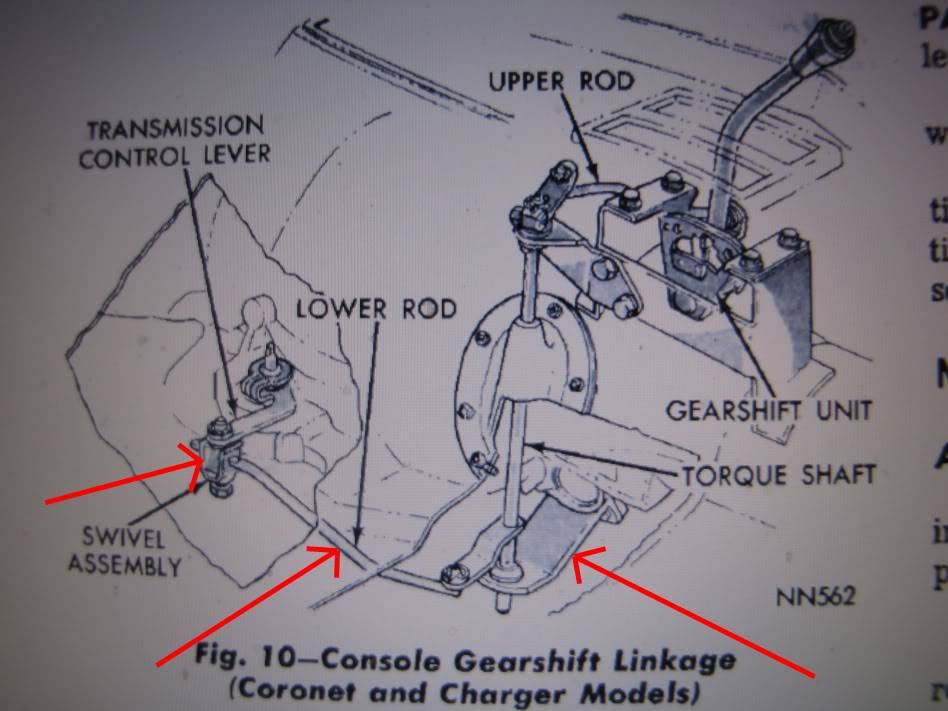

Hey 72,
Looks like you got it figured out already...Below is a pic out of a 68' mopar service manual. Pretty sure it's close to a 72'
