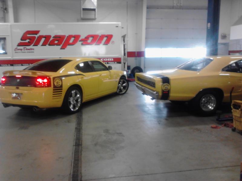

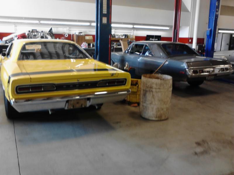

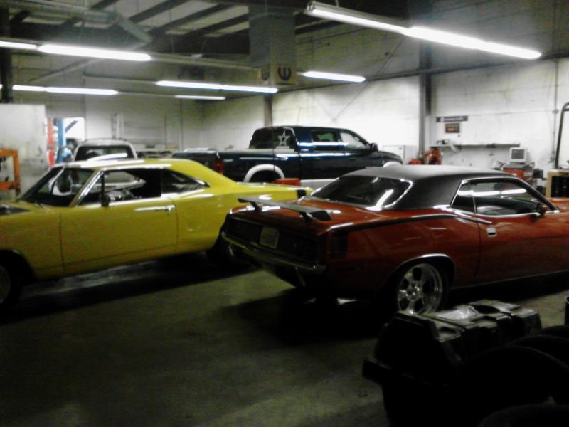

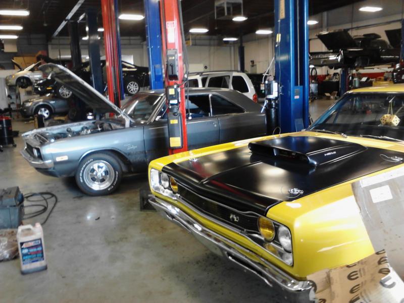

Hey guys i work for Chrysler dealer, I've recently had a few mopars come in.
I had a 69 SuperBee come in with a few transmission leaks, I ordered a reseal kit from Mancini. Its main leak was from the front trans oil pump, I replaced all the exterior seals replaced the o ring around the pump as well as the converter input seal. Long story short, test drove and let sit overnight. I came in the morning to a puddle, coming from the front pump. When i opened the reseal kit i wasn't convinced with the paper gasket, but i had no other choice. Are there any better kits or front pump seals? any recommendations?
I followed the reseal procedure by the book and torque specs from a few shop manuals I have for my 68 Coronet.

Have to say there's a few real nice Mopars in your post!
