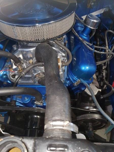

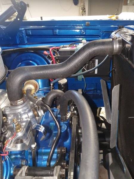

Does anyone know what number on this upper and lower radiator hose?

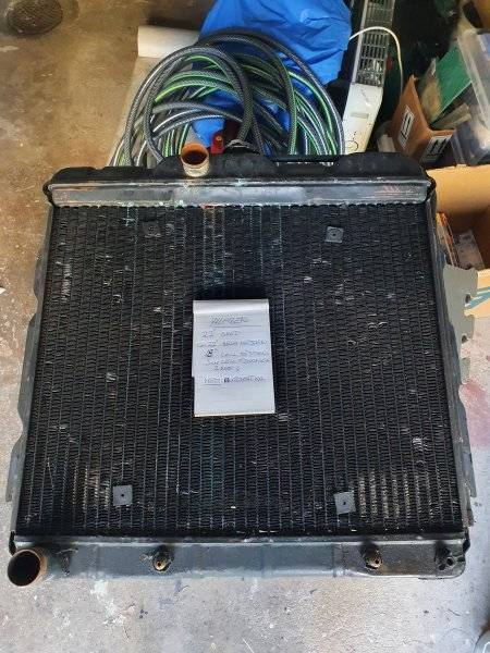

the original radiator is now redone and with 3 row.

I thought "LA" motors had the lower hose inlet on the other (passenger ) side? Try RockAuto for rad hoses. They usually have a picture of the hose, if this helps.
I come up with. upper OEM number 2863204 Gates 20594, Lower OEM 2658932 Gates 20386
Not shore, but the lower OEM 2658932 Gates 20386 sems to be right,
but the upper OEM number 2863204 Gates 20594 im not shore,,

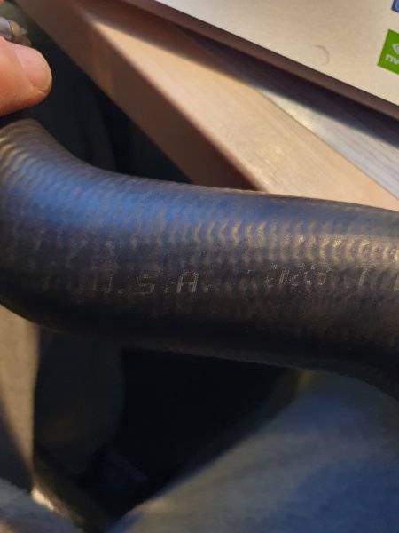

in the third picture i messure and get about 14" if i messure right?? (Gates 16,5)
in the sixt picture, from the table to the center of hose 6"

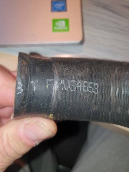

i have searched and not find anything of the number on the hose, what i can read, USA ..023 T EXU34653.
