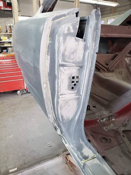

hello all, I've searched the forum and the googles and do not see definitive answers for these questions and I'm hoping you can help as the car is in the body shop now and is close to being ready for paint. Its 69 charger
1: quarter panels to door jamb.. no seam sealer goes here correct? Please see photos. See photos attached. Primer car photo is mine.. looks great just not what i remember it looking like.

Question 1 no,if anything you should of placed a sealer between the panel and door jamb lip before welding them.You will see what the factory did if you check some other areas on the car.like the front jamb n cowl area n in the rear around the wheel housing n window frame.Question #2 that script is moulded to fit the panel flush,when i did mine i kept my old panel n used it as a pattern for placement,i can get some pics for ya.Question#3 i dont know but some will know on here,mine came with the stripe.
If you are worried about that seal,get some epoxy primmer n brush from the inside along that seam,2 or 3 coats wont hurt anything
