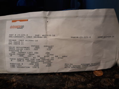

1966 satellite 78 440 fresh 30 over forged crank aluminum heads Comp Cams XE 284 / 292 cam Edelbrock RPM intake Edelbrock 750 carburetor number 1407 full MSD ignition p.m. 6425 Doug's 2-inch headers 3in exhaust with h pipe timing now at 11 degrees initial, engine is said to have 11 to 1 compression included is a pic of the cam specs
