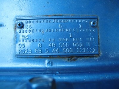

Guys,
As you know I have been building up a 1968 Satellite and now a 1968 GTX comes my way. I have not seen it in person, but it appears to be REAL nice with a few minor flaws.
I am being told that it was a "special order" Police Package. I see this sideways "N" or "Z" right under the "BC" column on the tag.
Can anyone help?

I'll stick my neck out on this one. Lots of people smarter than me will correct me (well maybe not, we'll see). Lots of opportunities to correct me ....
Nearly all cop cars were Belvederes in '68, with a few Satellites thrown in. (Maybe 90%-10%). You hear stories of cop Road Runners but no one has a documented one. (Anyone? Post the info if you got one!) So I'll say no to the cop GTX.
The "N" you see is an inspectors stamp from Lynch Road. It embossed the tag, and didn't punch through like stamps from St. Louis builds.
I note that the tire code is 44. That's for a F70-14 RSW. Pretty typical tire for a B-Body. The cop cars would have used an upgraded 8 ply tire, and the codes are 56 and 59 for 14 inch wheels, and 66, 68, 78, and 79 for 15 inch wheels.
I think you found a GTX. Still a special Mopar.

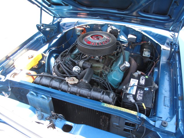

Yea its all badged up as a 68 GTX and I have no doubt it was born one.
The tranny cooler it has on it is kind of strange. Never seen one like that.
Don't mind the overspray...
Nearly all cop cars were Belvederes in '68, with a few Satellites thrown in. (Maybe 90%-10%). You hear stories of cop Road Runners but no one has a documented one. (Anyone? Post the info if you got one!) So I'll say no to the cop GTX.The "N" you see is an inspectors stamp from Lynch Road. It embossed the tag, and didn't punch through like stamps from St. Louis builds.
