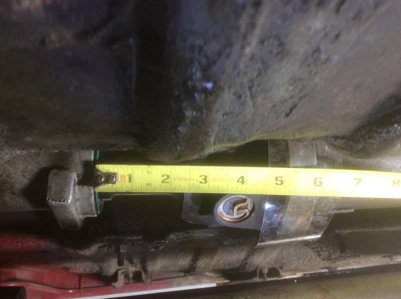

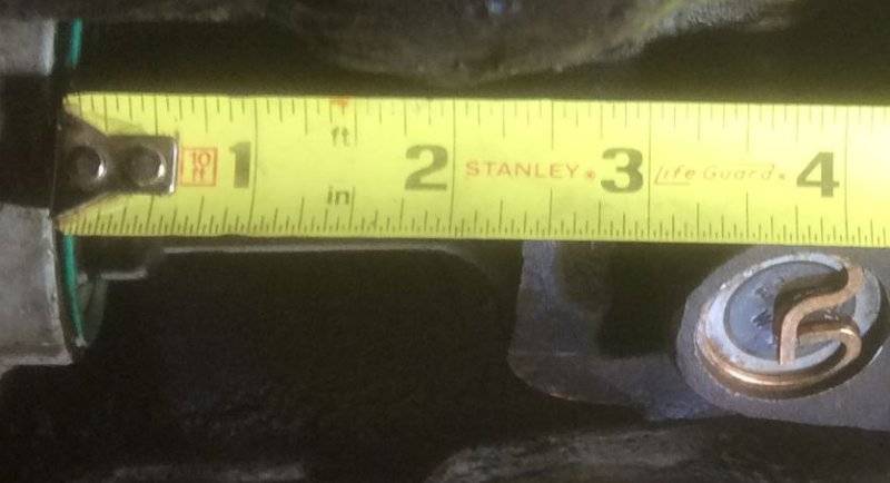

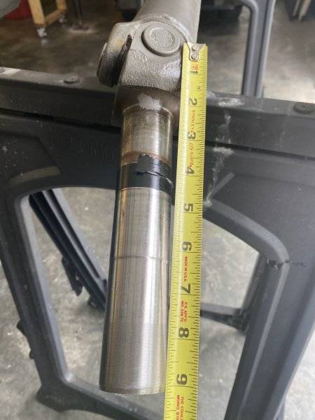

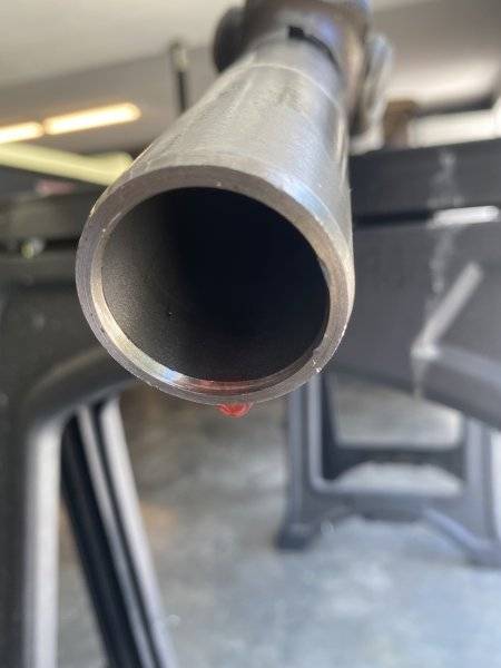

67 coronet new 904 trans and already tail bushing wore out. Drive shaft too short measures 55.5” cl to cl joints. U can see in pics how far it stuck out of trans about 3”.
8.75 rear all oem stuff locations.
When pulled my yoke has a machined step down and then spline starts. So I have no splines until 3” in on yoke. In pics u can see my tape line is where I marked yoke before pulled. Basically I only have 1 3/4” of spline being used on yoke. What is this yoke? Oem? Wrong one? Need help was going to lengthen my driveshaft about 1.5” longer but not sure now what to do.

727 it looks short because of the short seal cover. The out put shaft is at 1" to1.25" on tape measure.

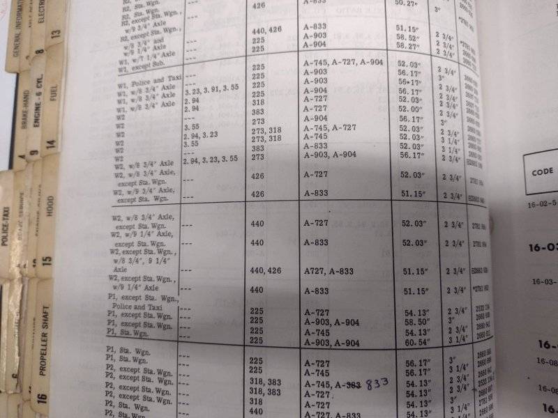

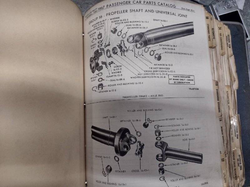

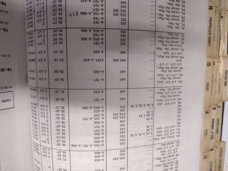

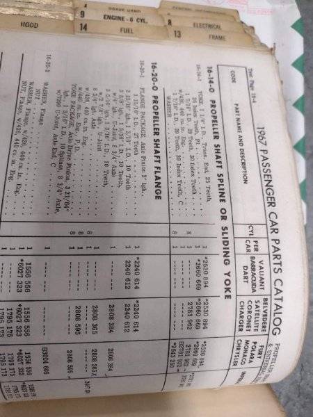

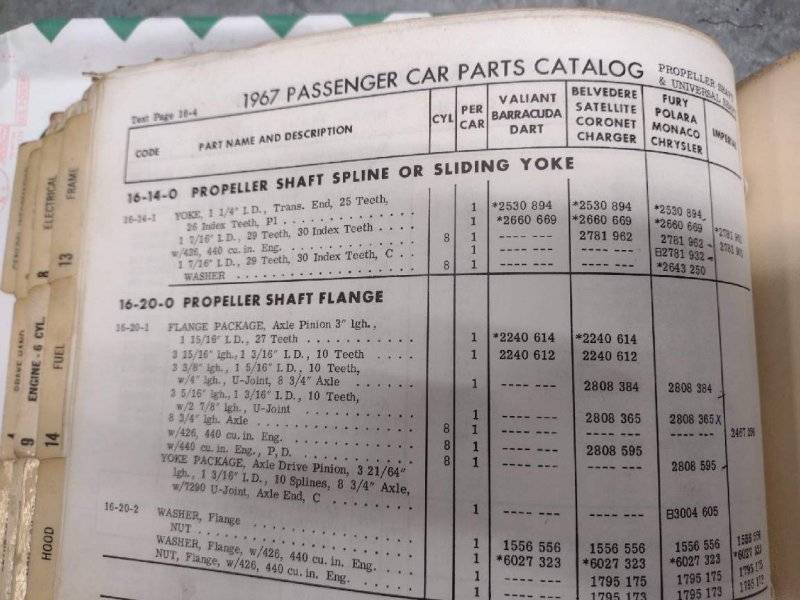

@Uncle Don I have a 1967 Factory Parts Manual. Looked up the driveshaft and yokes. According to what I am reading, the Coronet with a V8 is the W2 car line series. The only Coronet V8 showing a 904 trans is for the 273 engine. The 318s show as having 727s. Anyway, the driveshafts were apparently available in 2-3/4" and 3" diameters. Part numbers 2883-569, and 2660-550 respectively. The lengths are listed as 56.17". The front yokes are 2530-894 for one that has a 1-1/4" I.D. with 25 teeth, and 2660-669 for one that has a 1-7/16" I.D. with 29 teeth. (Those front yokes are the same across all car lines from A body to C body.) I will attach pics of the pages, but my new smart phone is too darn smart for me to get the pictures loaded the right way. You can twist your head if you want to see them.... LOL

Ahhh. My driveshaft measures the 2.75” diameter. Guess I need to be getting me a new 904 yoke. Any suggestions?

Why do you need a different yoke? Because there is the area of no spline so you can get the yoke started on the shaft??
Clean the seal surface off the yoke, and see how far it will go in the Trans.
The yoke is normal.
