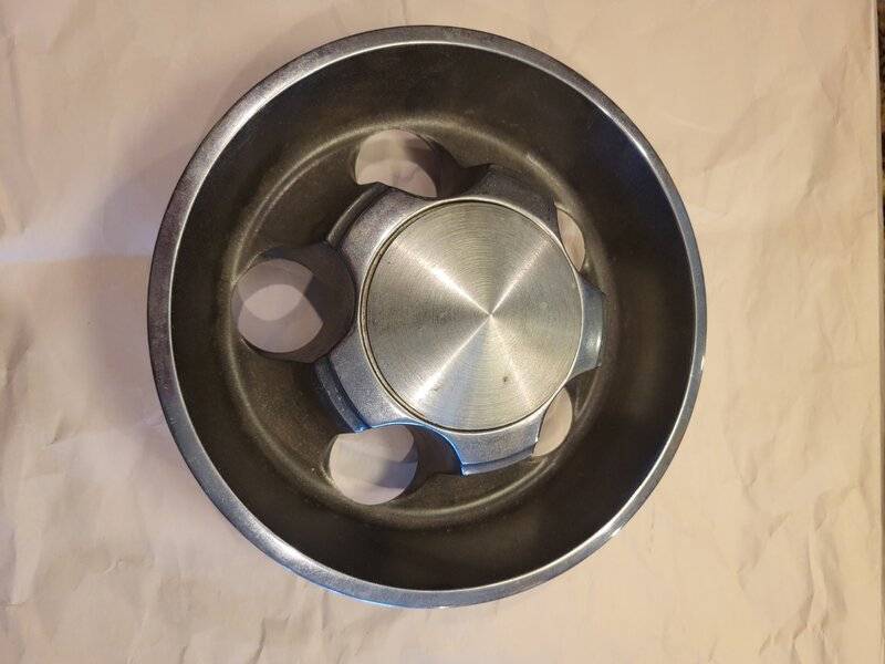

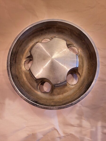

I posted over on FABO but never got a complete answer, maybe you guys might know.
Big Bolt Pattern.
Classic only shows the solid center style. '72-74
Does anyone know the years for these 2 styles?
Top one purchased on the net.
Second one from a '72 Barracuda owner who changed wheels.
Thanks!

The first style dome pictured, part number 3461458, was used on 1972-1974 models.
The second style dome with cap pictured, part numbers 3699006 (dome) and 3699008 (cap), replaced the earlier style beginning with 1975 models through 1976.
A third similar style dome with cap, part numbers 3699312 (dome) and 3699008 (cap), replaced the prior dome beginning with the 1977 models through 1978.
Vaanth, that sounds correct to me.
I think that was what I had decided had to be.
I appreciate your answer!
