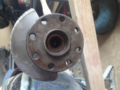

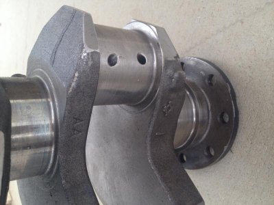

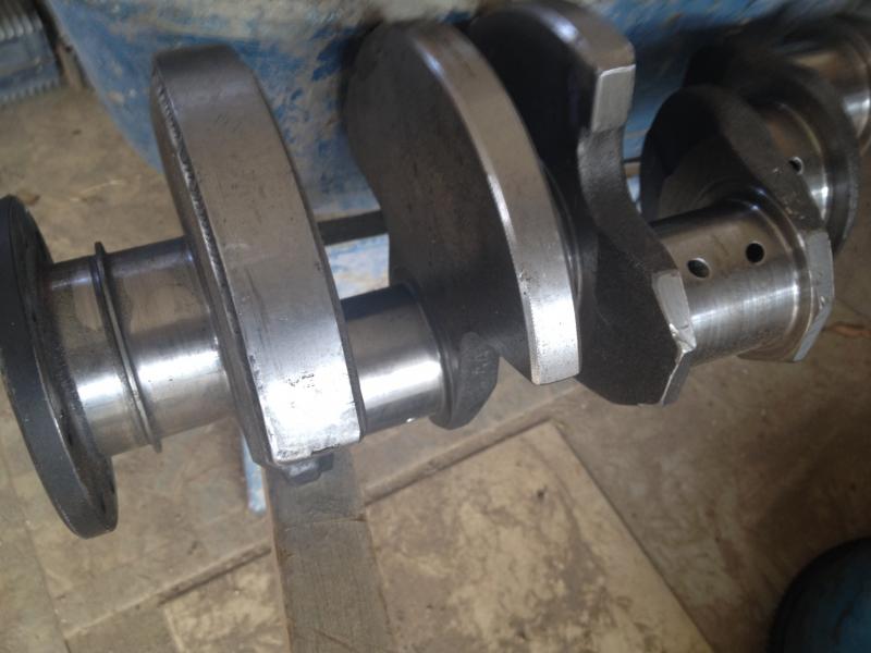

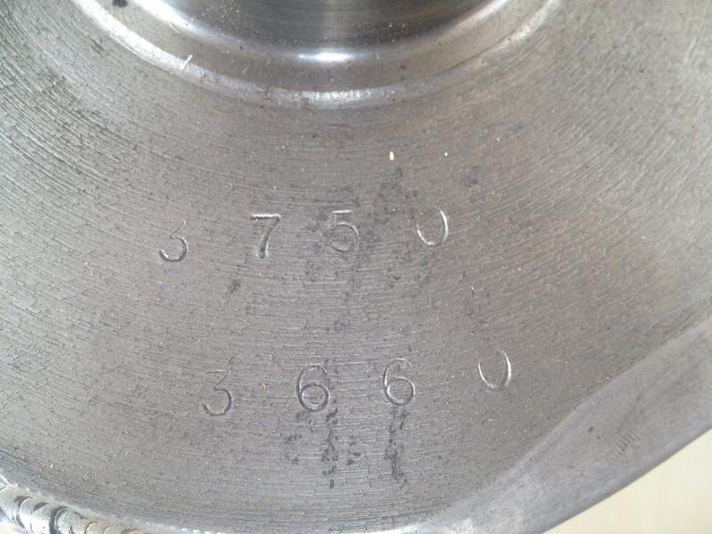

Bought a 440 and I can't tell of this thing is factory or aftermarket Crank....previous owner didn't know anything about it!!
If it is factory crank- it will have a raised casting number on it.......................MO
It has no casting numbers just a number 1 stamped on it... I'm thinking it's proably an after market piece ??
Would a hemi crank work in a 440?? It did have LY rods with TRW position
Looks like an old Kellogg Hemi crank.
Not sure if you could see from these pics but looks like weight welded to it also has 3750 & 3660 stamped on it

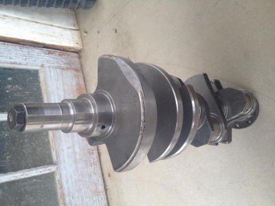

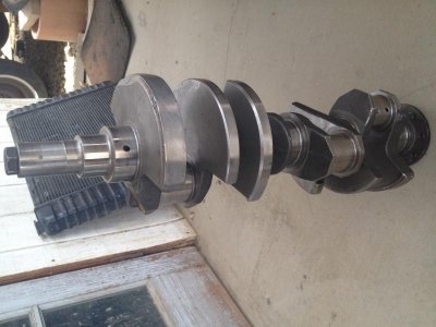

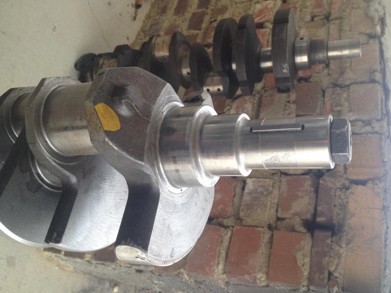

And some more pics
Thought I'd ask again, i know its a 440 Crank but not sure of the Manufacturer
yes, a hemi crank will work in a 413,440,426w, and a 1961 383, with the right flywheel and a proper balance job. ( I once put a cast 440 crank in a hemi!!!)
