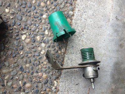

I found some parts in the glove box and I am not sure what they are for.
This one has 'CARB' stamped on the side above one of the nipples.

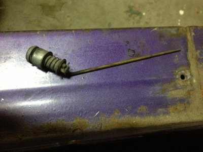

2nd one:

1. goes to the CAP emissions system, as I've seen on 1966 cars. fits on back of the engine. a vacuum hose fits to the fitting, hense labeled 'carb'.
2. a carb metering rod to an AFB /avs
