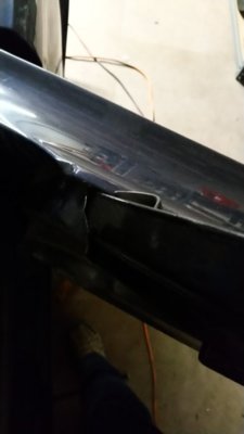

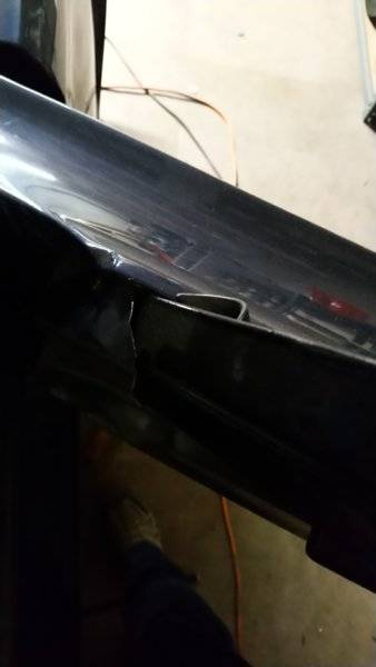

You can see here how the front part of the frame wedges down under the door jamb. This is why you have to tilt it forward a bit then pull up
