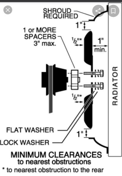

2. Air Flow --> A good point made by Don. Is your mechanical fan sticking into the shroud and pretty close to the radiator (good) or sitting way at the back side of the shroud (bad for air flow)? There's some optimal distance fan/radiator/shroud which I'm sure you can search for here. Also, is that fan clutch working? Does it lock up & spin fast when the engine heats up or does it keep on spinning at half-assed speed? Is the radiator clean (good) (& A/C condenser if you have it) or is it full of dirt/leaves (bad)? Is there a pretty much un-obstructed air flow path into & through the radiator? (e.g. no turbo intercooler, no oil cooler, no trans cooler, etc blocking radiator)

How far is the fan into the shroud?
