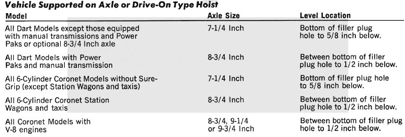

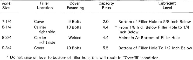

Here's the chart out of the 67 manual, and below that from the 72 manual. You can see some minor changes were made, but the 8 3/4 in 72 can indeed be run "to the bottom" of the filler hole:
You're better off going by level measured to the hole than volume. Depending on your differential (or spool?) the volume needs can be quite different.
