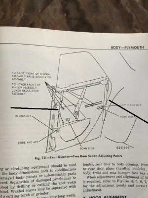

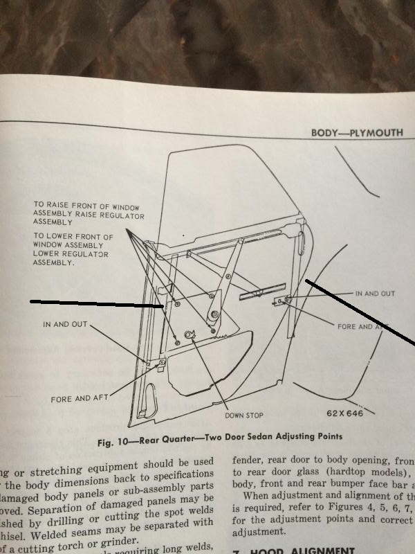

Get a 63 64 or 65 shop manual there is a picture in all of them showing the removal and reinstall.
Pic of manual
Marcel, hope this helps for now. Leonard

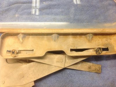

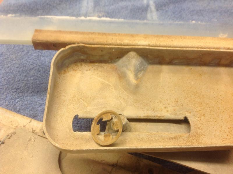

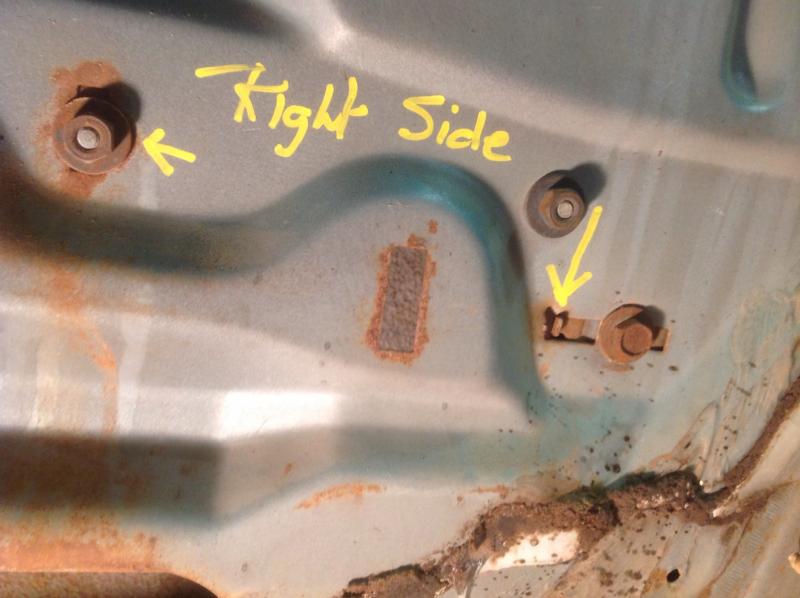

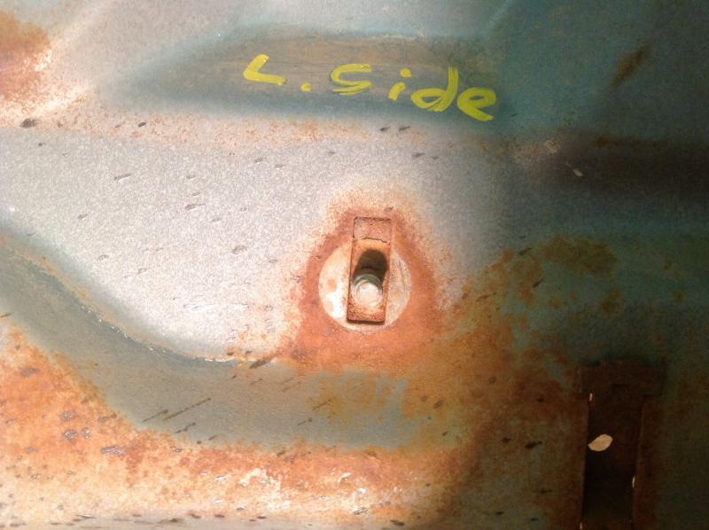

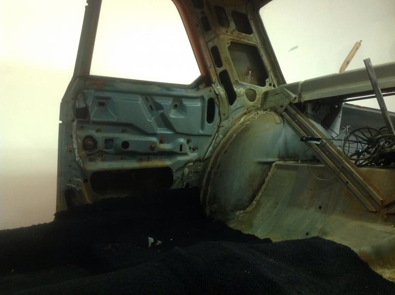

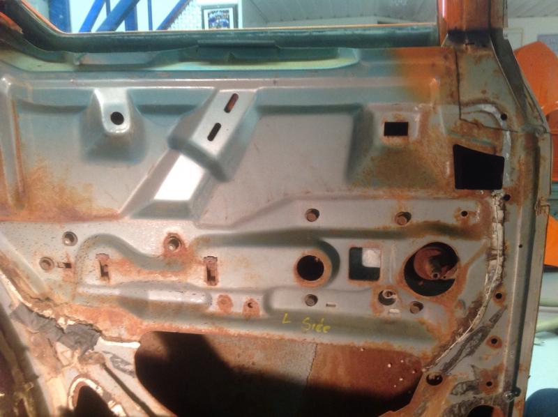

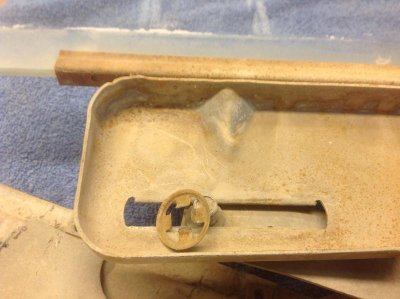

Hi Marcel. Here is some that i took of my 64 2 door post when it was coming apart. Check them out. Thanks,
Mike.
Hey guys, thanks for the quick replies!
Please look at the attached drawing; the guiderail at the rear; at the top it's mounted with a nut to the frame, but do you know how it's mounted on the bottom?
I see the pics from Malex, but are they mounted with some kind of support on the rail?

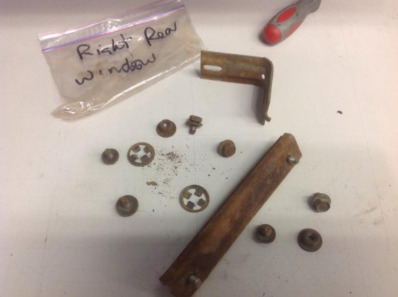

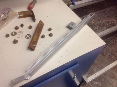

image.jpg Marcel, hope this helps. This is the right side rear wndow hardware (not blasted yet).
image.jpg Here's the rail in this pic. It bolts to the L bracket that is in the other pic.
