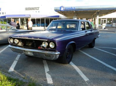

Hello everyone, i have been reading quite a lot on this forum but havent had the time to write much in order to get my car driveable to the Power big meet here in Sweden.
I just made it but it took some looong days/nights the last 2 weeks, luckily i had my brothers and a few friends to help out :grin:
Now to the problem that have followed this car more or less all the time i have had it since 1991. first the specs:
Dodge coronet 440 1965
originally 318" BB but now a 400" stroked to 512"
It has the original 11" drumbrakes with power assistance.
The problem is that while im driving the brakepedal engages higher and higher until the point the brakes actually locks up and i have to open a bleedervalve to let out the excessive pressure.
I know about the residual valve in the mastercylinder and that it should hold about 10psi in the system to get less travel in the brakepedal but this build far to much pressure.
What i have done:
Several years ago i rebuilt the old mastercylinder with a new residual valve and after that it was good for 1 or 2 years then it came back but not very often and i could live with opening a bleedervalve every month or so.
But this spring i did a lot of work on the car and exchanged the mastercylinder for a new one (Dorman 1") and the problem got a lot worse, i could only drive for about 45 minutes and the brakes started locking up.
I did a proper benchbleeding of the mastercylinder and bleed the system and after the Power big meet i dissasembled the mastercylinder and checked the residual valve wich looked good (after all it was new) so i then tried a perhaps not so good method but i took a needle and poked a lot of holes on the rubber membrane and assambled/benchbled the MC and the whole system.
After that i could drive quite a bit longer but the brakes still locked up eventually :angryfire:
So, im kinda lost what to do now? Are the returnsprings to weak maybe? Could it be heat from the exhaust manifolds causing it? Maybe some air still in the system?
Any and all help would be greatly appreciated.
Here is a photo also :grin:
