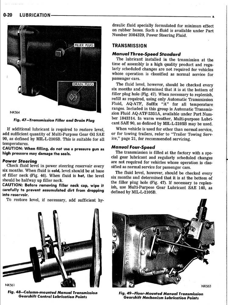

I found this page in the shop manual, it is said to ATF transmission oil in the 3 speeds. I'm a little confused.
Huh, it says use ATF in a manual gear box or use 90 weight in 'warm weather'. Never seen that before, not that I'm an expert.
