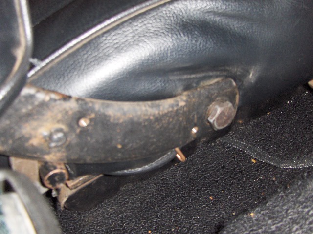

you talking about the ones behind the plastic cover on the hinge portion?
I'd be happy to look for you. Just let me know for sure what I'm looking for.

Hey Thanks Red Runner
Yes those be the ones! Now I know why nobody is responding to my request:sign13: they are covered with that black plastic cover, if its not too much trouble that would be awesome , have had my car apart for over 3 years and it did not have the covers on when I bought the car,one more thing I need to buy I guess, is the cover on both sides or just by the door? thanks so much!
Love your car very , very nice, one more question did you put new seat cover backs on your car and if so how did you attach them, I have the new covers but they are just basically flat cardboard with a vynal covering??? any thoughts? I thought I might use velcro? thanks again CD
Here ya go Clay,

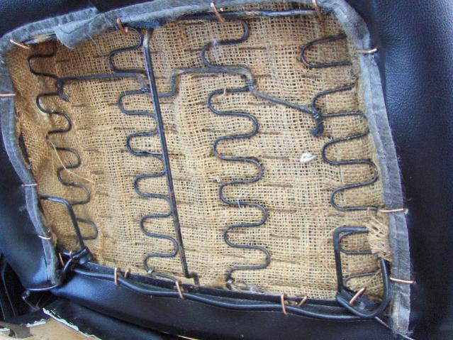

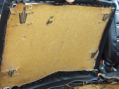

pix of the seat bolt. There are covers on both sides of the seats. As for the seat backs, there should be 4 clips on the inside that hook onto the seat frame work by pushing in and sliding up the seat back cover at the same time. Then there are 2 screws that go in from the bottom to hold the cover up.
Here are some pix of the seat back for reference.
The hooks grab the "L" shape bar on the bottom corners and the little "U" shaped bump-outs on the top.
