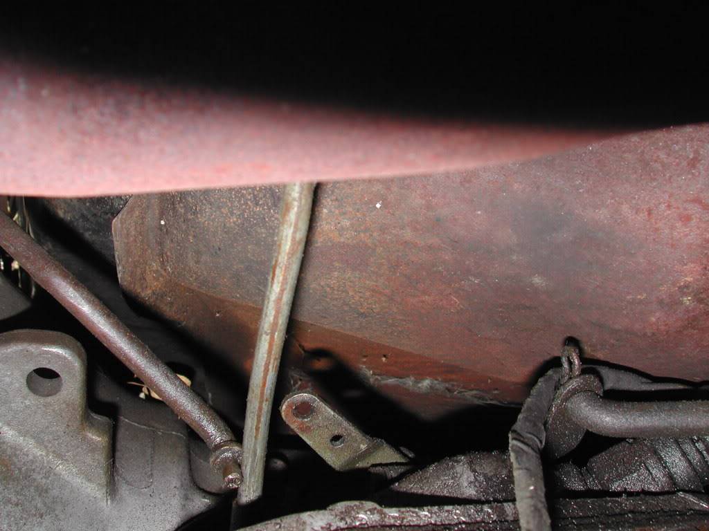

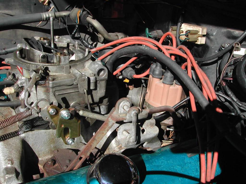

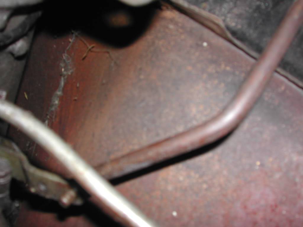

The spring can be had at any auto parts store and I will look at mine when I get home and let you know how the kickdown rod connects. This I have an aftermarket edelbrock carb and weiand intake.
You need the long kick down stud at the carb linkage.

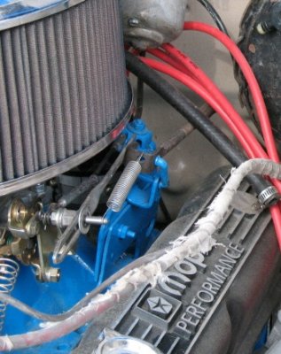

Not the same set up as you have but here is a pic of the kick down. with that same bracket you have.
Here is the setup i have, same engine/trans but without the rods, i found this to work great..
