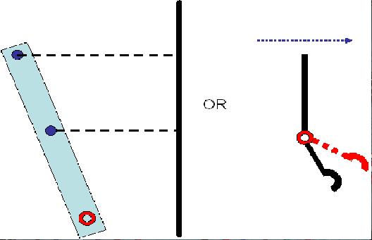

I don't have any experience with tunnel ram linkage but the distance of travel on the linkage has to change. You can either move your linkage connections closer to the pivot point or tweek your pedal mechanism to gain a longer travel.
Look under the pedal mechanism, on my 67 there's a little tab that I was able to trim down to give more travel.
