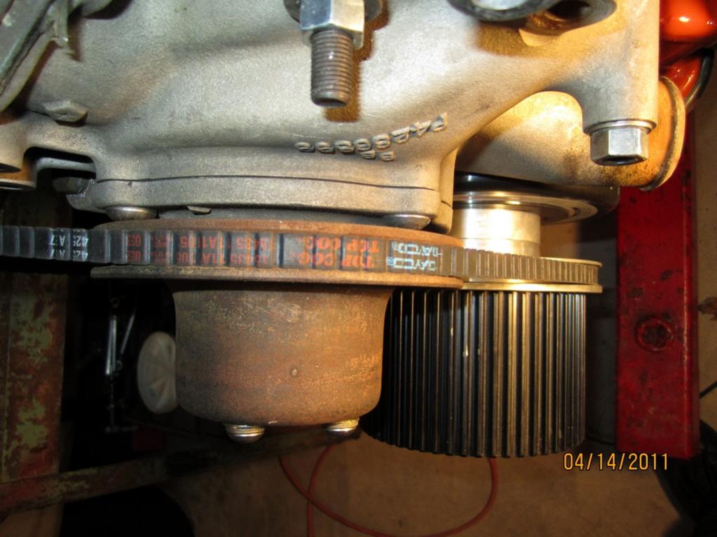

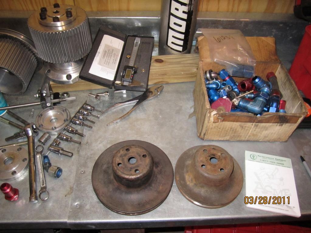

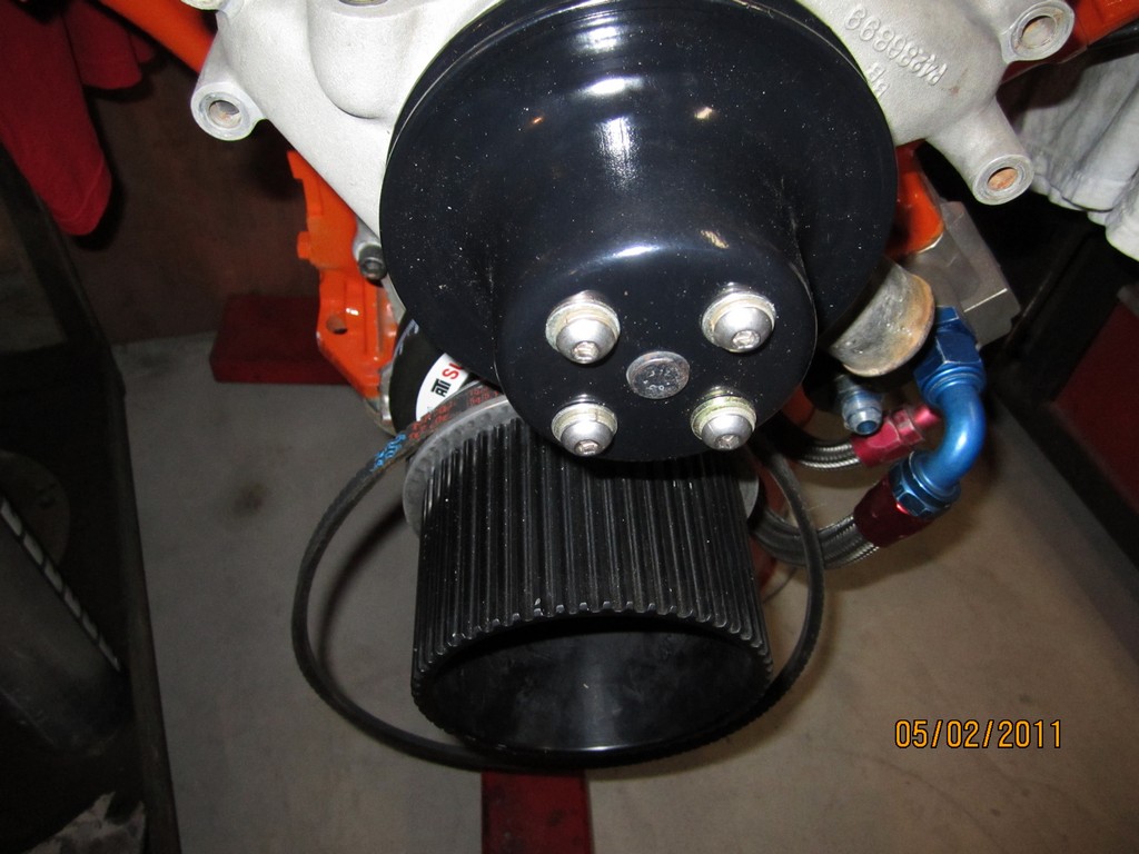

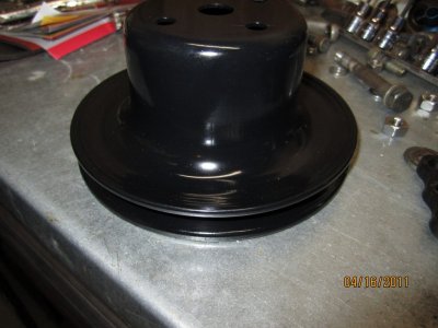

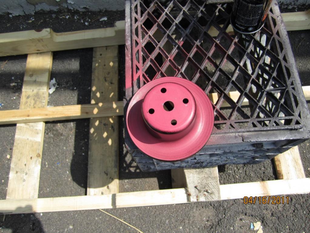

The bolt pattern is the same,the backspacing may be different.Different size spacers are also available.I ended up with a few washers under the pulley for perfect alignment.

I just happen to have had some pic's in the HEMI-ITIS archives.Glad that worked well for ya:tongue5:
