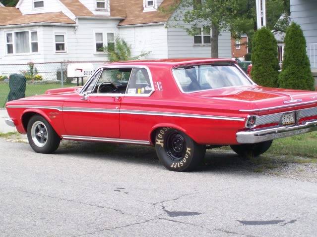

I use 15's in the front and rear. The front are just a standard radial tire that is 215/75-15 and the rear are 30 x 9 x 15 Hoosier radial slicks which I drive on the road all the time. Front wheels are 6" Torque Thrust and rear are 7" with I think a 4.25 backspace. I dont remember the backspace on the front wheels. Ron
