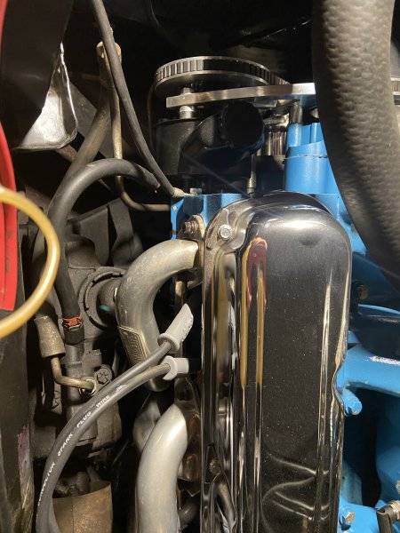

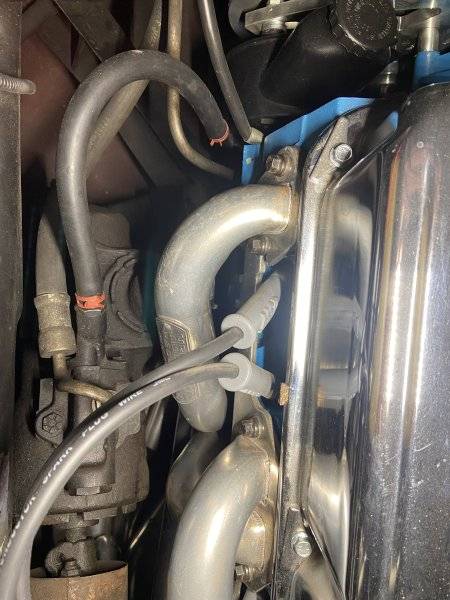

Hey everybody. I need to replace my headers on the 318, 1973 Road Runner. I bought a set but the power steering is in the way. Anybody out there have any suggestions on what might fit? Thanks in advance!
