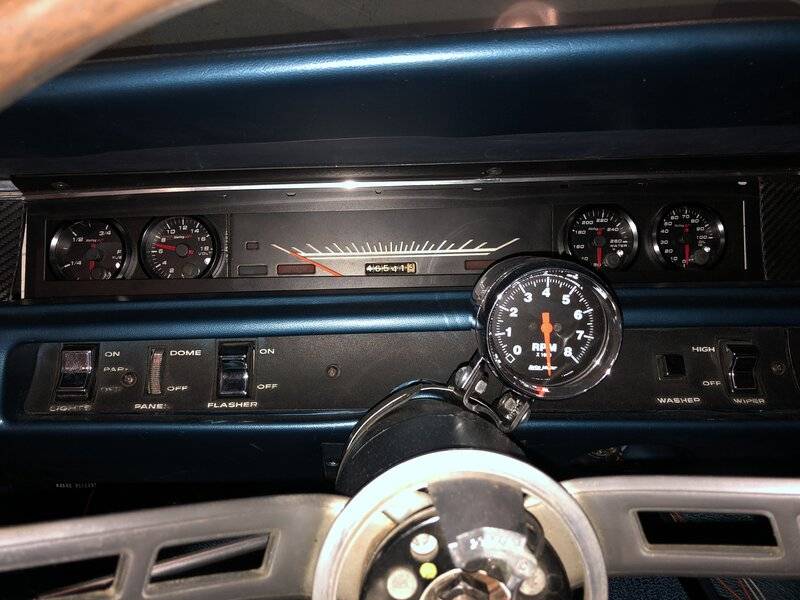

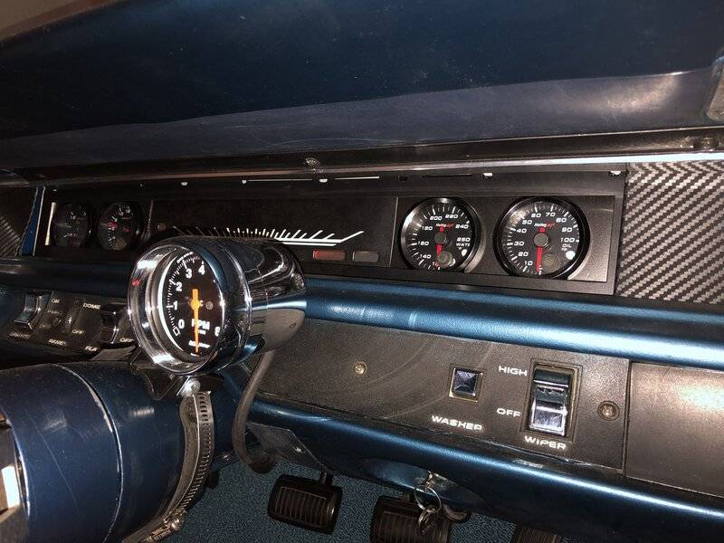

I am in the process of buttoning up my interior after a complete re-wire and switch to Holley Sniper EFI. During that process, I added Holley digital EFI gauges in place of the stock parts. The Holley gauges run off the Sniper ECU which renders the orignal mechanical gauges kind of useless. So it it is what it is now, no going back. That said, I am sort of stuck on how to finish.
So here's what I am trying to resolve. I need to have an instrument panel lens with the speedometer numbers on it because on the standard dash lens, they are part of the lens and not printed on the face of the speedo. Unfortunately, the '68-70 standard-dash lens has all the gauge lettering engraved into the back of the lens which naturally obscures the new gauges I installed behind it. There's no way of removing the lettering without destroying the lens. I tried and wound up destroying it. If there's anyone out there who thinks you can cut 2" circles out of a 52-year old instrument panel lens with a hole bit in a drill press, I'm here to tell you you can't.
I considered leaving the lens off entirely but doing so leaves a large gap between the gauges and the lower dash pad which I'm not happy with. The next consideration was to get a piece of Lexan or acrylic plastic, cut it to fit and just kind of fasten it down over the gauges but then I still don't have the speedo numbers. I even went so far as to call a gauge restoration place in Canada that makes the speedo lines for the gauge face but they said they do not the numbers. Grrrrr...
I have thought about removing the stock sweep speedometer and replacing it with an Autometer type speedo but the opening is really too short to fit anything other than the original rectangular piece. AM makes a 3 1/8" diameter speedo but that's the smallest one I could find, everything else is 3 3/8" or larger. Basically this means no off-the-shelf aftermarket gauges will fit without fabricating some sort of panel that sticks out over the lower dash pad to accommodate the height.

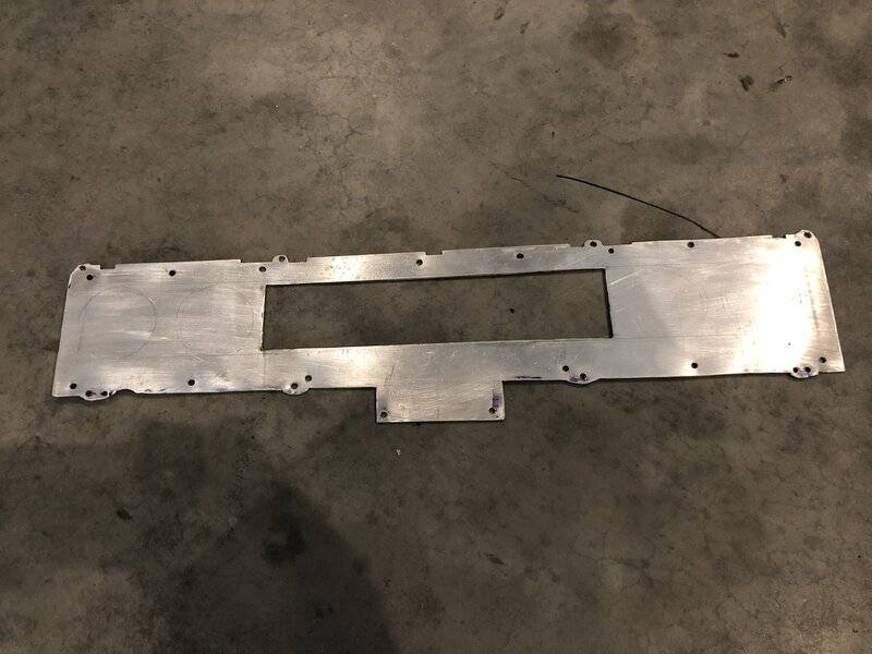

Earlier this year I actually started to make a flat panel but stopped short of completion because it was proving to be kind of difficult and time consuming. Plus, cutting the rectangular opening defeated the purpose of adding an aftermarket round gauge. Perhaps I could put another panel in front and hide any fasteners behind the trim but I'm not sure I want to get involved with something like that again.
PG Classic out of Canada carries new standard dash lenses. I called them at one point and asked how the letters were printed onto the back of the lens. The guy on the phone said they were not engraved but merely screened on. If that's the case, that would work great because theoretically one could scrape off the lettering leaving the speedo numbers in place. I have no way to know for sure if the guy on the phone understood what I was talkinbg about so if I buy one and it's engraved like the original, I own it. Can anyone verify whether the gauge lettering is engraved or not?
I even called Dakota Digital to see if they would sell me one of the bezels they use for their instrument panels (which I really don't like at all) but it wouldn't work because it's an LCD screen.
I've looked until I am blue in the face - no company out there makes any sort of custom panel for the standard dashes or I would have bought it. Right now I am thinking that I will just buy the lens and if I can remove the original gauge lettering then I win but if not, I will just have to live with it and move on.
So based on all that, does anyone have any ideas or suggestions to finish this up to have it look OK and function like it's supposed to?
