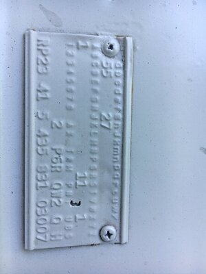

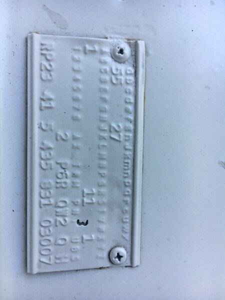

Hello
Just bought a 67 Satellite and I would like some assistance with the fender tag.
Thank you
Neat car
67 satellite 2 door hardtop
318 727 column auto
2.94 Open 8.75 rear axle
7.75-14 WW tires
August 31 scheduled production date
Dark red roof paint
White body
Red pinstripe
Red bucket seats with buddy seat. (Dark red like maroon)
Upper door frame paint-dark red
A/C
26” radiator
Tinted glass-all
AM radio
Fender T/S indicator
Door edge guards
