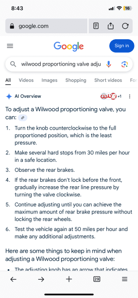

It should be adjusted so the rear brakes don't lock up.

Prop valve adjustment process from Wilwood. Make sure those drum shoes are also adjusted correctly
