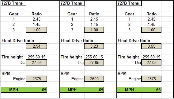

Thanks for the details Rusty, knowing the factory stall versus factory high speed stall helps me. Attached is what I had calculated as FDR vs RPM at 65MPH for my vehicle. Go slower than 65MPH in rush hour on I-75 and you can be crushed.
